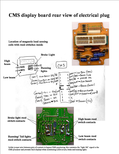

You can add jumpers to the CMS board and bypass the reed switches in the load coils for the warning display. It is probably a good idea to resolder the plug connections to the board to prevent future problems anyway. I posted a picture showing the layout of the CMS boards before with the directions when I went all LED on my '83 Standard Venture. You can read the post here [ame=http://www.venturerider.org/forum/showthread.php?t=33285]Pinout of the "information display" on the dash - VentureRider.Org[/ame].
I have more pictures of the board if you need them. NOT for the faint hearted, but not that difficult.

Here are a couple of views (front and back) of the CMS board with the load coils and reed switched inside them. I also have a hand written layout of the CMS plug showing the pin functions of the wires going into and out of the CMS assembly.
I added jumper wires to the back of the board and bypassed the reed switches so the lighting current through the load coils have no effect on the warning display. Since the LED lights are virtually a lifetime proposition, I don't really need to monitor the health of the lighting circuits. I will bypass my headlights (high and low) at a later date when I go the HID route with the headlight.

After reading this thread I decided to dig into the display of my 84. I knew right away that the display would be different than the 83's covered previously in this thread. I found two much more complicated PC boards. But as with the 83, my 84 also had the same reed switches. I'm guessing that the 84-93 displays are the same. Please correct me if I'm wrong. I attached a few pictures of the 84's display innards and the reed switches that need to be jumped. One picture shows where to solder the jumpers. The green jumper is for the running/tail lights and the black jumper is for the brake light. Now I no longer have the annoying red warning light. I also didn't have to add any of those expensive resistors that the manufactures of the LED lights suggest adding inline to each LED light.
Thanks for the previous information provided earlier in this thread that showed me where to start this LED fix on my 84.
