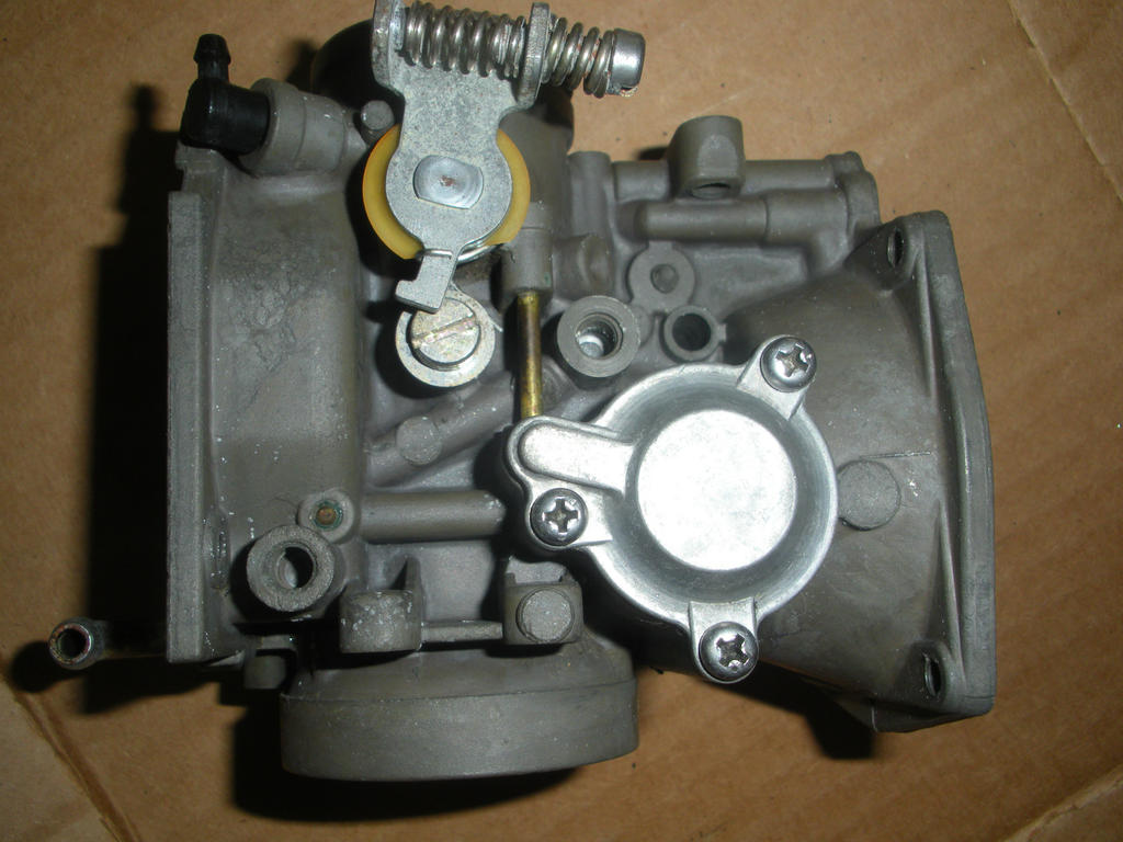

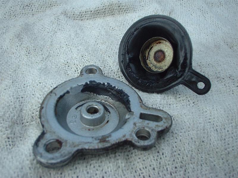

While you have the carbs apart, check the air bypass diaphragms (little diaphragms on the side of the carbs). Mine were stiff as cardboard! Ordered some off eBay and now the idle works much better with adjust screws set at the recommended two turns.
What are the "air bypass diaphragms" you mention? Do you mean something associated with either the starter plunger or the coasting enrichment diaphragm (under the small, round cover)? I just finished disassembling and cleaning the carbs on my '93 and want to make sure I didn't miss something.
Edited by Bob K.
Link to post
Share on other sites
What are the "air bypass diaphragms" you mention? Do you mean something associated with either the starter plunger or the coasting enrichment diaphragm (under the small, round cover)? I just finished disassembling an cleaning the carbs on my '93 and want to make sure I didn't miss something.
These would be the diaphragms for the sliders. Cover for them is on the outside of the carb, square, held in place with 4 screws.
Link to post
The "air bypass diaphragms" (I've never heard the coasting enrichment diaphragm called that before) that ssparks905 referred to are in fact, the coasting enrichment diaphragms aka air cutoff valve. If you did not disassemble and examine the diaphragms for tears, swelling, cracking or stiffness when you "cleaned" the carbs, you did not get the entire carb cleaned or properly rebuilt (if rebuilding was your intention).
:happy34: Good! I did indeed inspect and clean the coasting enrichment circuit.
