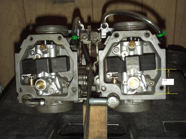

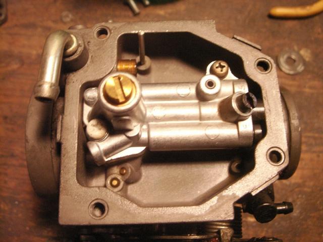

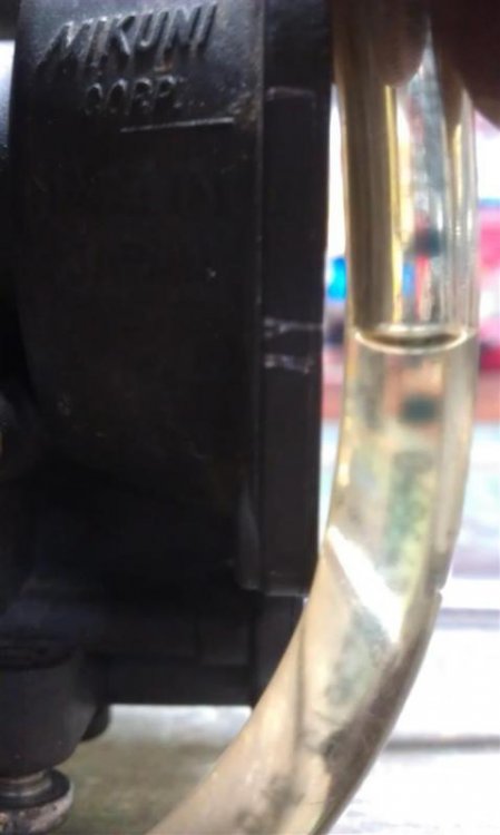

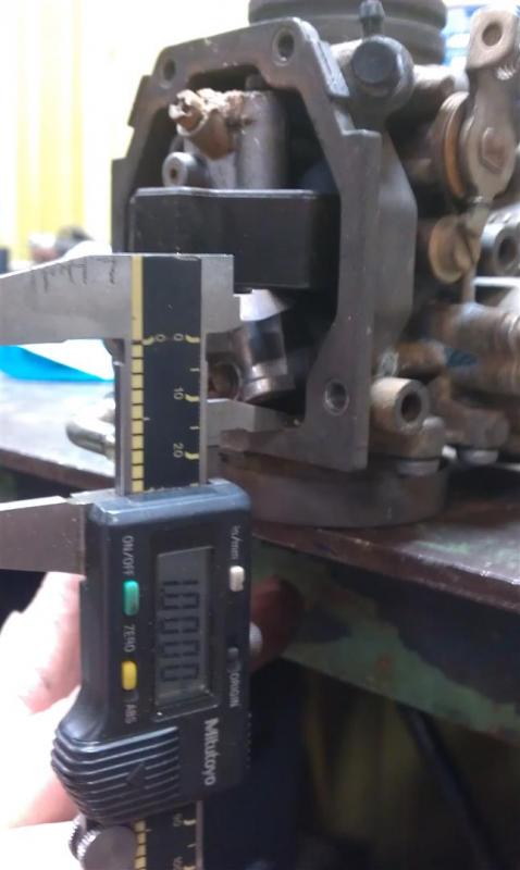

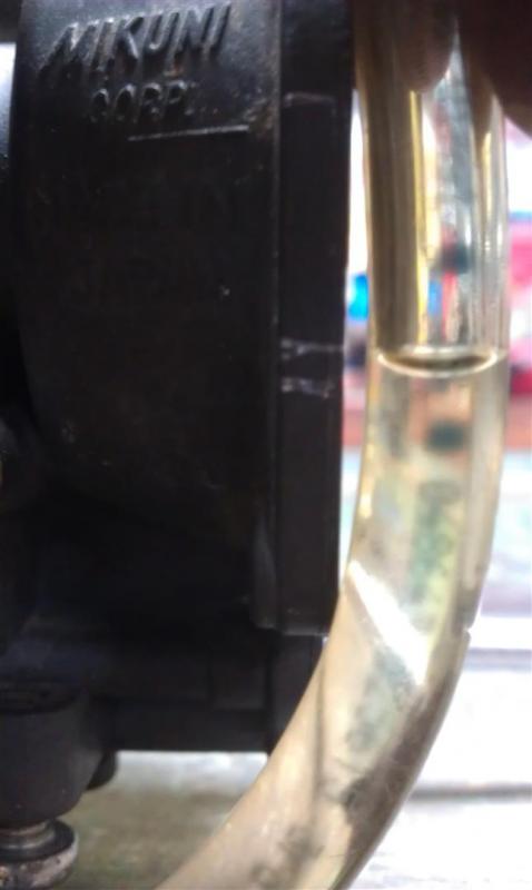

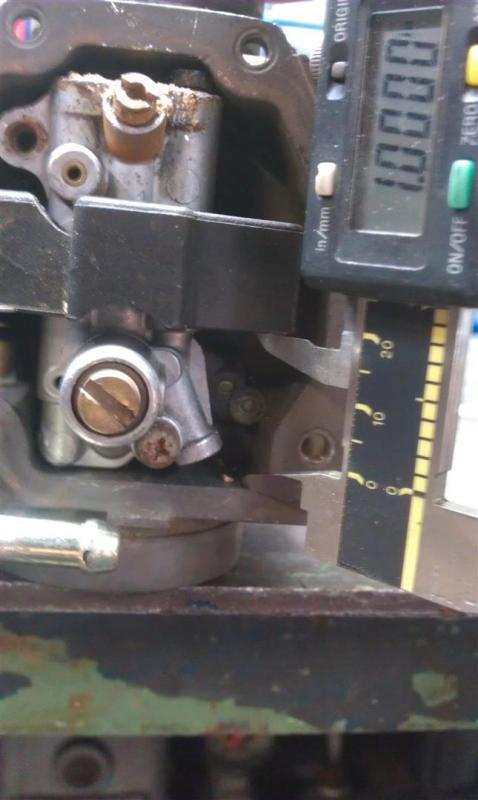

Got lots of comments and that was what I hoped for.
OK the bike idles fine. Runs good all the way up to red line at less than full throttle. In any gear giving it full throttle the bike begins to miss and bog down above 5k rpm . Removed one of the air filters and housing totally. Can get full throttle in 1st and sometimes second. But when in third can't give it any gas without bogging and missing. I pulled the carbs last night and I'm going to try to reset the floats today following Goose's writeup. Its just weird when it miss/bogs/takes off for a second then bogs again.
Oh yea, Iridum plugs so theres no gapping them and all 4 look the same
Link to comment
Share on other sites
Based on this, I'd look at fuel pump, fuel filter, or gunk in the main jets (but I'd also put in new regular plugs). Can't hurt none to do the float levels since you are there, but I'd be real surprised if it helped those symptoms. The only thing that would match would be floats too low, and there is virtually no way that can just develop on it's own. :080402gudl_prv:
